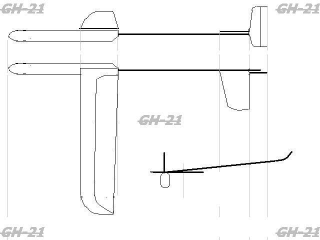

iwan21 wrote:Libur kemaren iseng oret2 gambar glider, kira2 gini jadinya

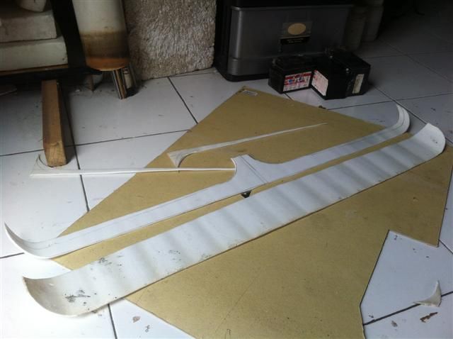

terus coba iseng2 motong polyfoam 3mm, sayap dulu, body belom
KFm-2, wingtip dilipet keatas
kelar dilem
wingspan 100 cm
wingchord , root 10cm, tip 8cm, rata2 9cm
jadi wing aspect ratio dapet 1 : 11 kira2
panjang fuselage mungkin 60 - 70 cm
body depan pake polyfoam 5mm, tailboom pake carbon tube 5mm sepanjang 40cm
target berat sih 100 gram ,
dg power kemungkinan pake motor brushless 10 gram
esc 6 Amp
servo 2x 1,7 gram
batere lipo 2s/350 - 500 mah
Mudah2an kekejar sesai target
:mtp
