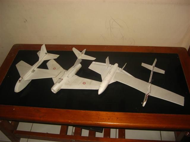

iwan21 wrote:4 armada imut, baru satu yg udah terbang ( jet Kutu) yg 3 belum, masih nunggu musim terang dulu
Satu meja muat buat 4 pesawat. :hmm

Re: Kumat maning, mikro funjet
Mejanya salah ukuran pakde, salah beli sayah :gg
....nunggu gambar dan spek tawon yg paling kiri dan paling kanan............. :cta
Paling kiri : Jet Kutu,
viewtopic.php?f=15&t=14348
AUW 48 gr
Wingspan 34 cm
Fuse 31
Power EDF 27 dg motor 10100 kv
Lipo 2s/240 mAh
Servo mikro 1,7 gr/2 ( rudder dan elevator)
Yg kanan :U-10 micro motor glider
viewtopic.php?f=15&t=14711
AUW 10 gr
wingspan 35 cm
fuse 30 cm
Motor direct drive brushed 6mm (pusher) dg prop 44mm
Lipo 1s/75 mAh
Single actuator (rudder only)
