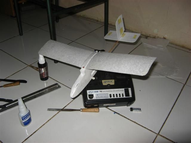

yagus wrote:berikutnya nyoba pusher dan ganti model wd
kayak gini kan om ?? :cling

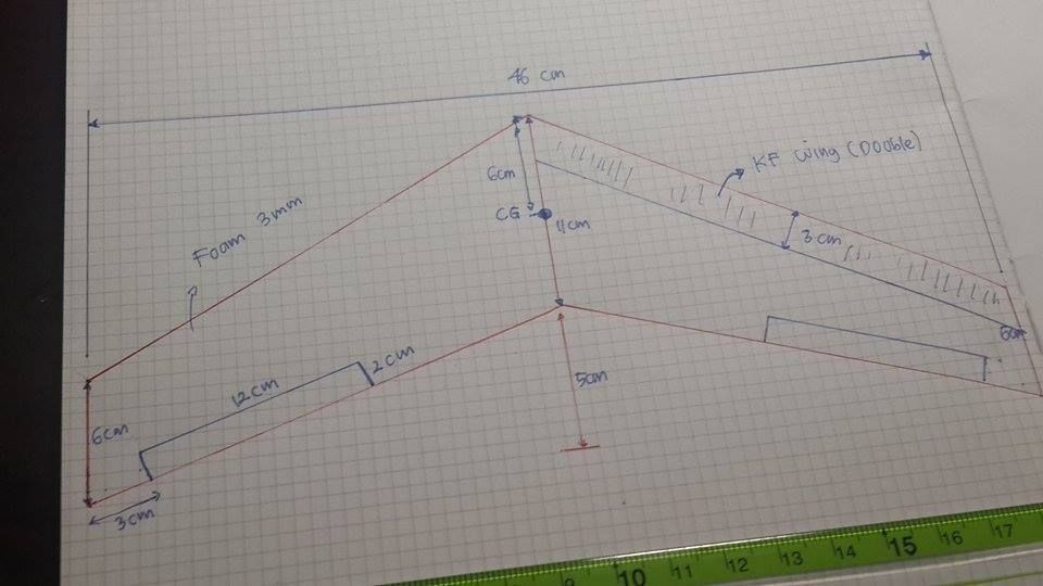

plan simple micro flying wing
