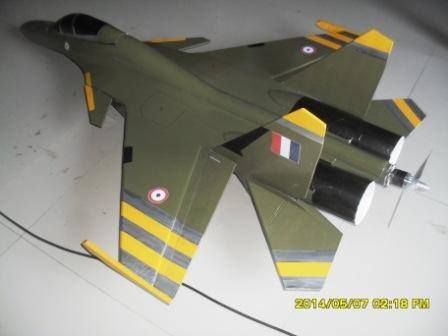

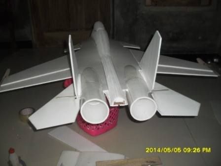

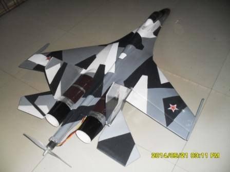

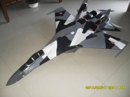

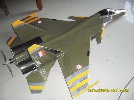

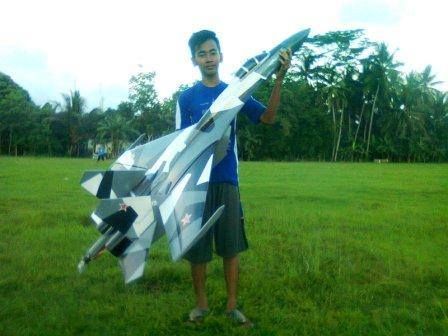

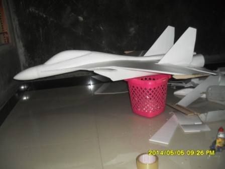

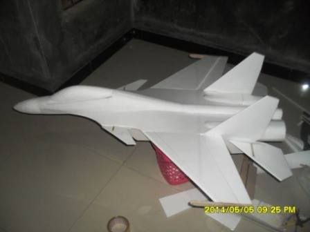

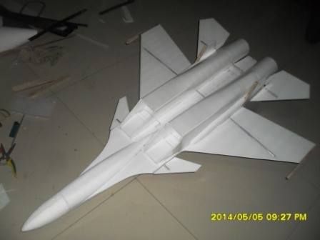

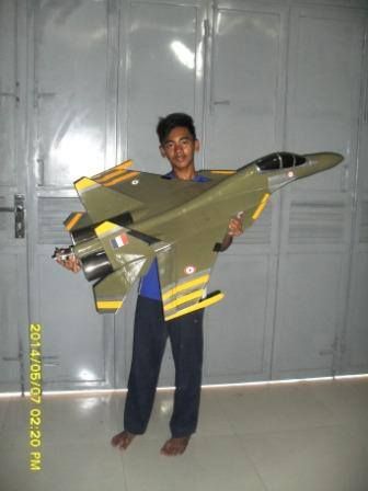

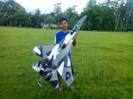

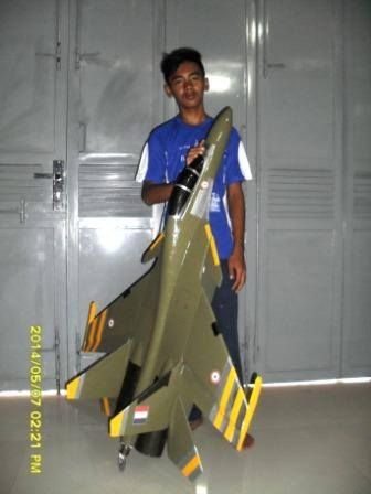

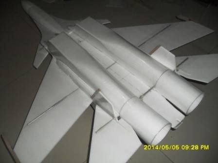

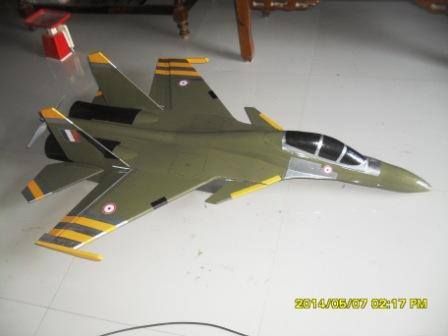

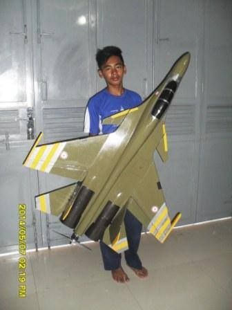

LAGI
RC JET SUKHOI BAHAN DEPRON UKURAN BESAR
SUKHOI SU-30MKI IN PROGRESS BY tgsHOBBY”
SPECIFICATION :
WING SPAN : 100CM
OVEREL LENGT : 140CM
ALL UNIT WEIGHT /AUW = 1300 GRAM
MOTOR : PROP DRIVE 35-36-1400KV
ESC = TURNIGY PLUS 60 AMPERE
BAT = LIPPO ZIPPY 4S 2200 Mah 40C SERIES
PROPELER = APC 10X5 INC/ 11X5 INC
SERVO = 4X MIKRO SERVO 9 GRAM HXT
CANARD FULL FUNGTION
SUKHOI SU-35 BY tgsHOBBY” SPECIFICATION : WING SPAN : 108CM OVEREL LENGT : 165CM ALL UNIT WEIGHT /AUW = 1700 GRAM MOTOR : PROP DRIVE 35-36-1400KV ESC = TURNIGY PLUS 60 AMPERE BAT = LIPPO ZIPPY 4S 2200 Mah 40C SERIES PROPELER = APC 10X5 INC/ 11X5 INC SERVO = 3X MIKRO SERVO 9 GRAM HXT

eki_sianto wrote:Keren abis om, bisa donk minta plan nya
plannya gak ada Om,..langsung corat-caret di kertas manila :ktk
