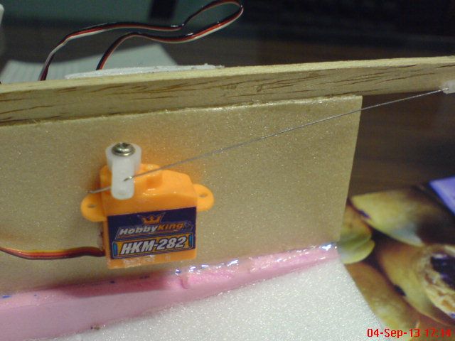

indoor flyer om :gg ......tapi sampingan'e ya........compass cutter ini.............
sedang indoor flyernya baru pasang "push wire" pake metal string guitar , krn ga punya carbon rod 0,6 mm

Re: indoor flyer " HANGER RAT " ......with RC...
push wire :D pake metal string guitar , smoga kuat.........
tinggal buat control horn nya saja , pake karton yg diperkuat pake lem CA

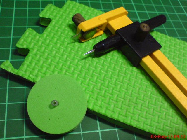

NF wrote:bikin roda , pake spons EVA , dapet bekas dari 'baby day care' deket rumah , 'as' roda pake isi ballpoint
Jangka yg bisa cutter aluminium max 1mm ada g pak..?

Yah..Om Fadli... :hi3
mbahas jangka cutter lagi, padahal udah di semprit sama om arto :hi3

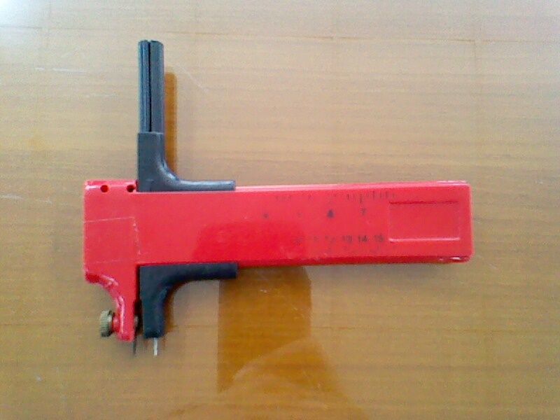

:hah .........................naek...............................
.................... :pyg ................dari rp 88 rebu ,kerna dollar naik jadi rp 165 rebu.......
.... :? .....men-temen yg psen , batal aja ya ......, ni harga jadi kena thermal dan up-up away........

NF wrote::hah .........................naek...............................
murahan di cibubur dong pakdhe... :hmm
115 rb olfa compass cutter

NF wrote:push wire :D pake metal string guitar , smoga kuat.........
pushrod kuat, lah baja 0,6mm kan persis guitar string kakunya
utk horn, selain karon+CA, bisa pake balsa 1mm+CA atau plastik tipis bekas bungkus/kemasan batere atau sejenisnya atau map plastik atau film bekas photo rontgen

............okeeeeeeee................masih ada stok plastik bungkus batere alkaline :byg :byg
