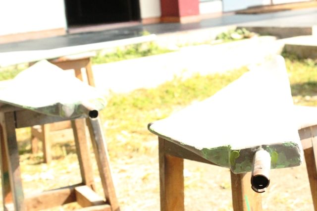

dulbehek wrote:waah bisa dipraktekkan ini.
tapi masih ngeri klo di suruh bikin propeler.

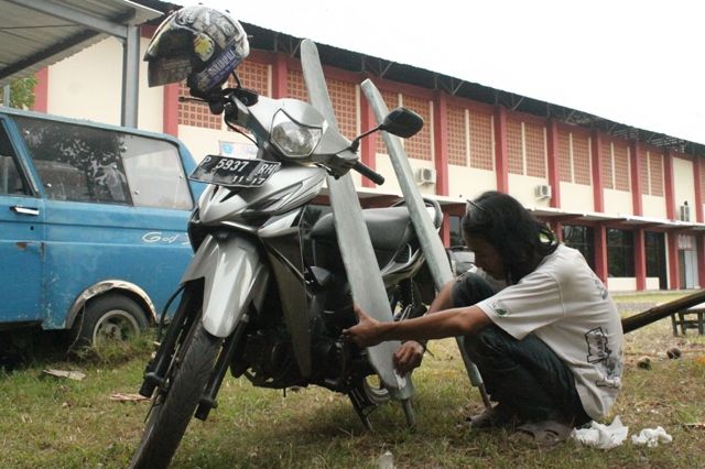

Doel.. prop-nya apa kayak geneee... he..hhee..hee
panjangnya 150cm... gawe plane opo yoo...
joun
Posts: 2027
Joined: 12 Apr 2007, 15:46
Location: jember
Re: EXPERIMENT #5 : CETAK MENCETAK DG SILICONE RUBBER
Post by joun »
segene kira-kirane... lumayan kaaannnn
