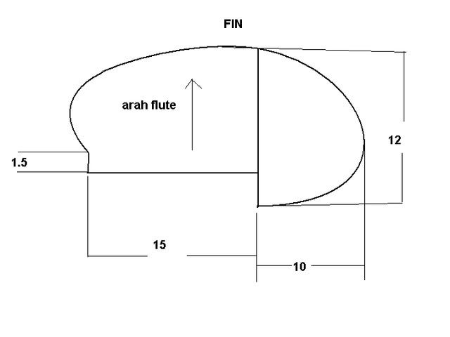

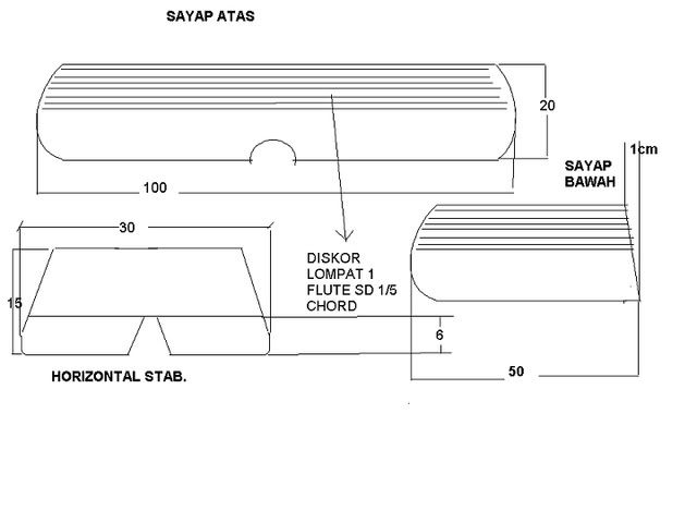

PLAN WING DAN HORIZONTAL STAB
tambahan....Plan Fin
