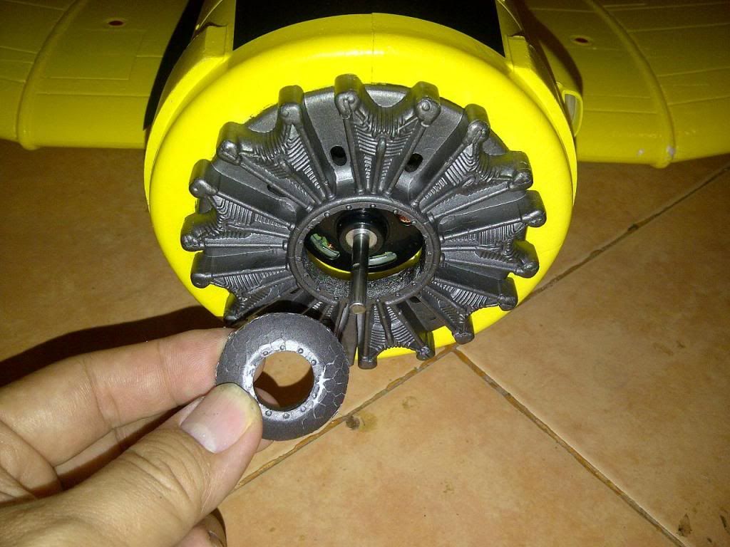

Power House, scale look... but very annoying to remove the cover!
For better air cooled... Get a razor... cut and make a Big hole! .... Image

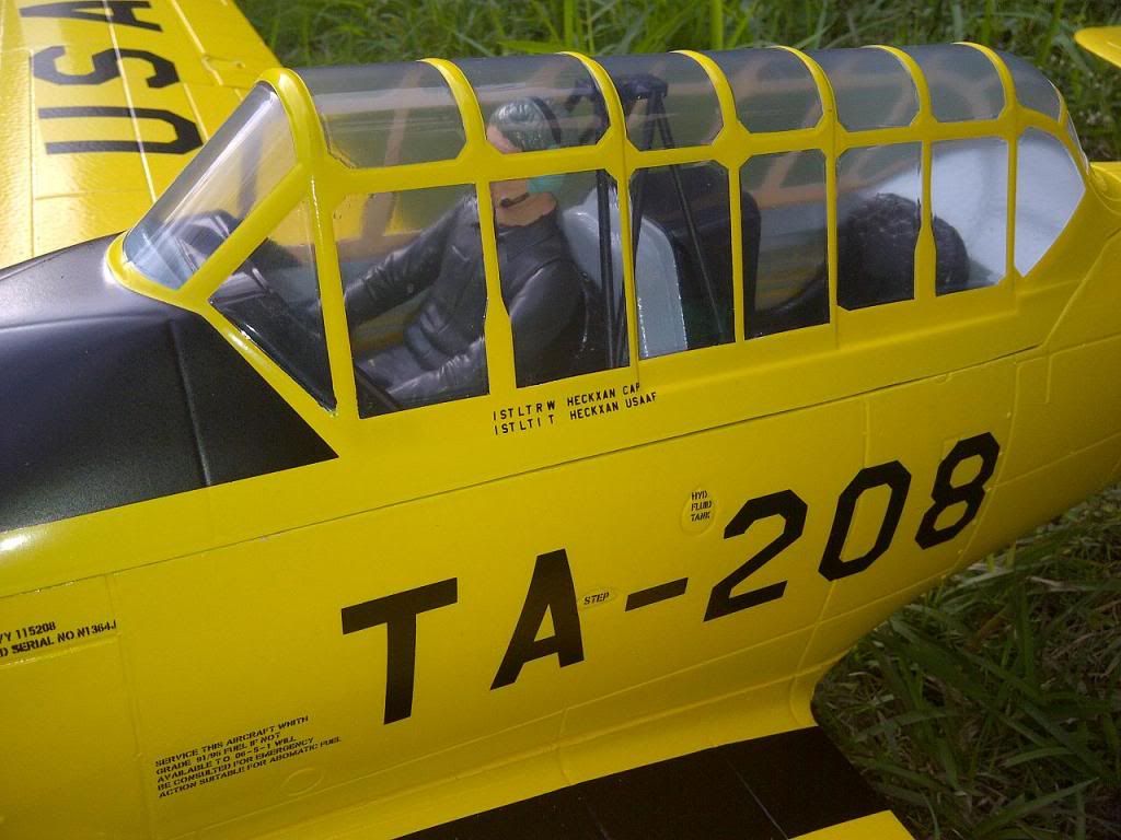

scale look detail cockpit... amazing!

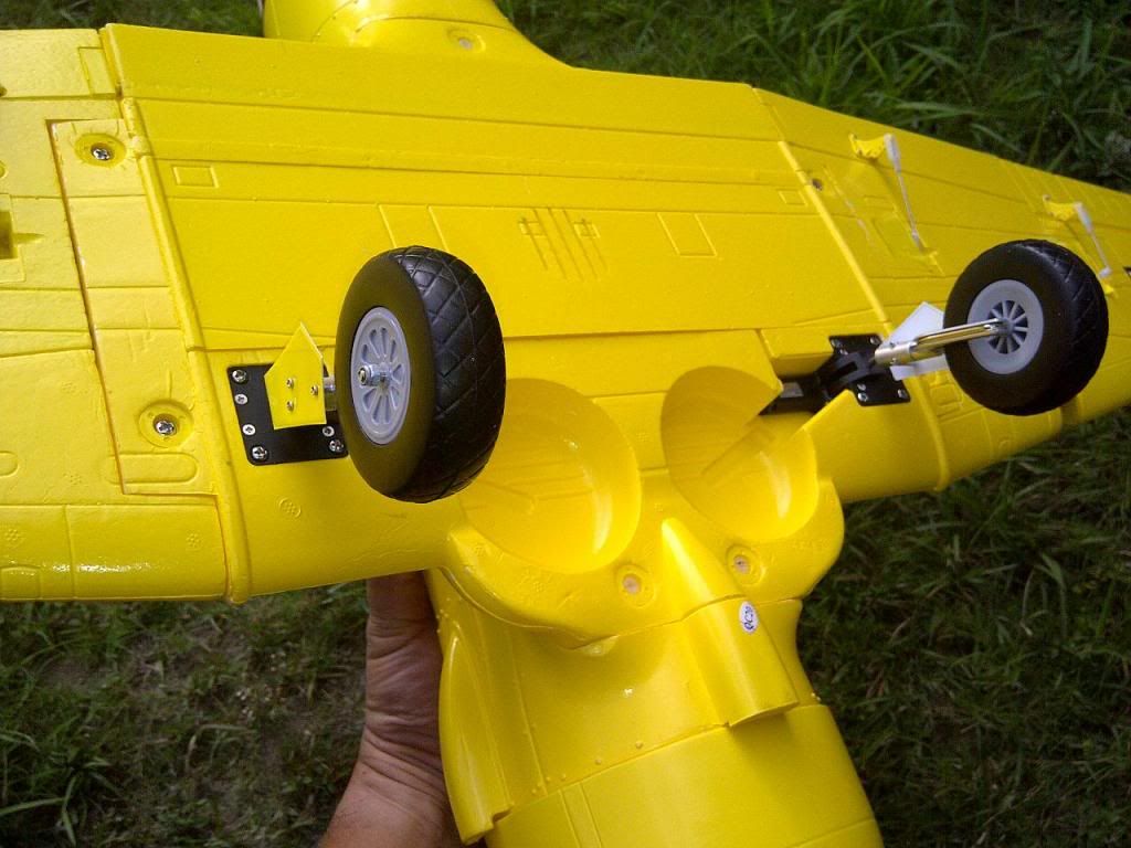

Smooth Retract landing gear system... very good (but less the shock absorber)!

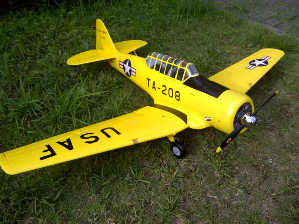

Look ma yellow sexy body.... Setelah terakit (sebelum di modif) mejeng dulu...
