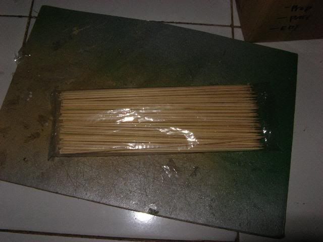

Saya selalu nyetok ini, buat spar
tusuk sate/barbeku 30 cm

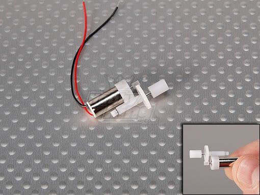

trus belom lama dateng micro power ini, barengan sama GPS-07 di pesawat pak GM ( 20 gr)
GPS-06, ada dua biji
Specifications:
Type: Brushed
Dimension: 14 x 6mm
Shaft Length: 5mm
Shaft Diameter: 0.8mm
Weight: 1.95g
Max current: 1.3A
RPM: 3V/40,000rpm at no load
Suggested prop: GWS 4025
Test data;
Prop: GWS 4025
Voltage: 3.5, 4.0, 4.2V
Current: 0.50, 0.55, 0.60A
Watts: 1.75, 2.2, 2.52W
Thrust: 13, 16, 18g
Efficiency (g/w): 7.43, 7.27, 7.14

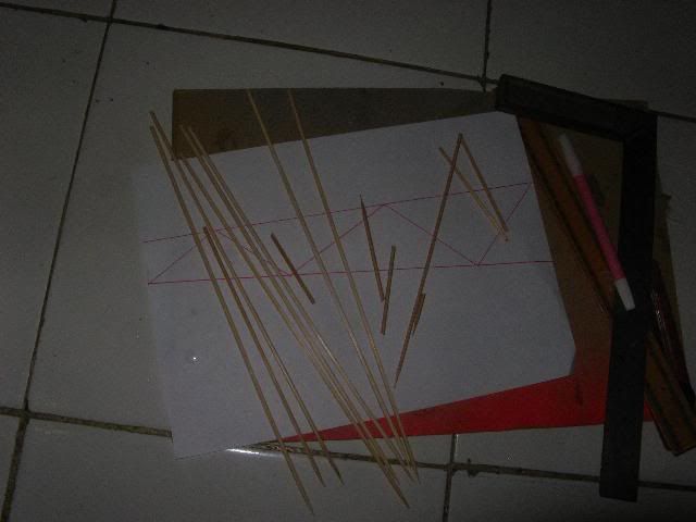

ambil tusuk sate beberapa batang, menghayal sebentar (oret2 dikertas :D )
30 menit kemudian

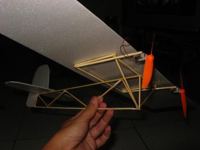

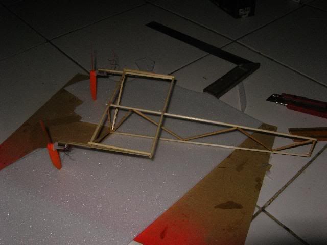

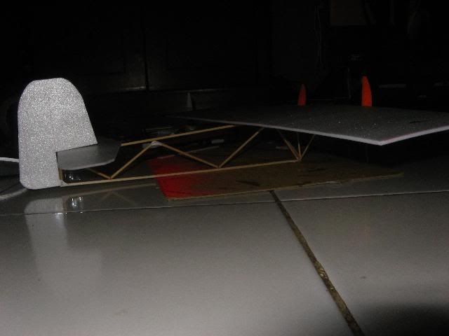

tambah 30 menit lagi :D :D

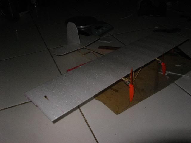

berat dg dua motor = 24 gr....
target AUW = 40 gr

ini ukuran2nya
panjang , dari ujung rudder sampe ujung prop = 33 cm
wingspan = 55 cm
wingchord = 13 cm
bahan rangka = tusuk barbeku 30 cm
wing, stabilo, fin = polyfoam 2mm
motor = 2 x GPS-06
prop 4025 GWS
ESC brushed 3 amp/1 gr utk lipo 1 sel
rx mikro 3,5 gr utk lipo 1 sel
servo mikro 2,5 gr x 2
lipo 1 sel/240 mah/20 C
silahkan...
