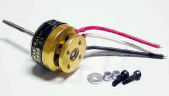

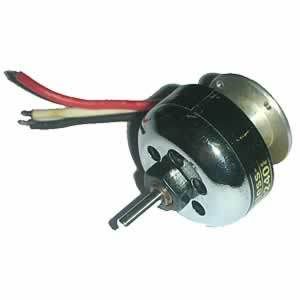

BP21 / TowerPro 2408-21
Model lama
Model baru
Max Efficiency: 80%
Length : 6.5cm
Diameter : 3.5cm
Weight : 46 g
Working voltage : 7.2-12.6v
Shaft Diameter : 2.9mm
Battery : 2-3 LIPO
Speed constant : 1750 rpm/v
Propeller : 2 cell Lipo : 9 x 4 / 3 cell Lipo : 8 x 4
Motor Specs
Configuration/ Propeller/ Volts/ Amps/ Thrust
Direct Drive / 8040 / 7.4V / 8.2A / 12.0 oz (342.86 grams )
Direct Drive / 8040 / 8.4V / 8.6A / 13.8 oz (394.29 grams )
Direct Drive / 8040 / 9.6V / 11.1A / 17.0 oz ( 485.71 grams )
Direct Drive / 8040 / 11.1V / 13.1A / 21.0 oz ( 600 grams )
